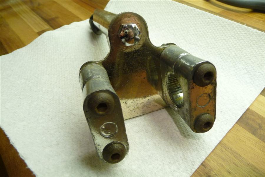

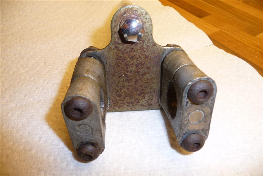

It still ain't no prize winner but it's a damn site better than it was  :LolLolLolLol:
(PS It's got the wrong stem bolt  :( )
BEFORE :
AFTER :

come up canny that john , what did you use ?

Was it the good ol' Lemon juice again  ???
Bit of Autosol on the Clamp and Bob's ya uncle  :D

Dean / Joff - I just put the main body of the stem and the bolts in white wine vinegar for 24 hours and then gave it a rub down with scrunched up tinfoil  ;) The blocks just got a very quick rub down with autosol and need a bit more TBH. I may yet do a full resto on it but I wanted to clean it up and see what was left of the gold on the stem - quite surprised what was underneath all the rust and happy with it for now  :)

I stripped this Kashi clamp down with a big hammer for one of the bolts as it was rusted solid. Left it in vinegar for well over a WEEK (doh! I forgot about it) - stank like a bitch when I took the lid off, but 5mins on Hootshi's polishing mop and hey presto....... the power of household chemicals is once again revealed :daumenhoch:
