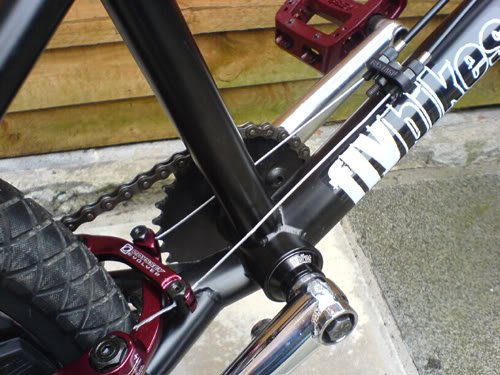

« Reply #7 on: April 12, 2010, 12:44 PM »
Ed,
The pic below is an evolver set up in the same way, except your two cables will cross over behind the seattube and go into the diagonally opposite brake arm.
Like wirewheel says, stick a regular cable clamp in one side, and a grub screw type of nipple clamp in the other, and it should work fine.
This is only the case for twin lower gyro cables though. If you're running a single brake cable from the lever, just get a straddle cable and regular cable hanger and ignore the two cable guides at each side of the seattube altogether. If you need a straddle cable and hanger, drop me a PM. Should have something here that'll work which you can have foc.
Brian  :daumenhoch:
