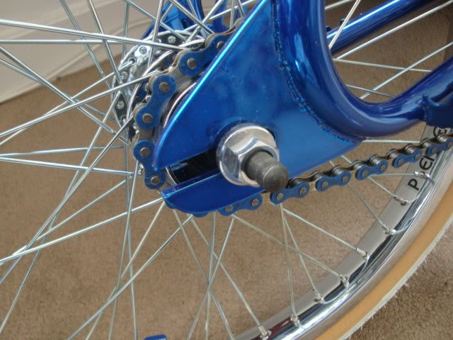

I've mounted rear brakes on a few trickstars now with no problems ... but i have one here that i just mounted a rear nippon on and the pads do not reach the rims.  I have moved the rear wheel right in on the drop outs as far as it will go and they still wont reach .. almost an inch off!  So i compared it with a couple of other frames and the brake bridge has been welded on higher up nearer the seat post that the others  ???
The brakes are fine on other frames.
Can't see what i can do about this .. any ideas?

OK... the top pic is another frame where everything fits perfect, note the position of the brake bridge ... then the blue one has the brake bridge a lot higher and the last two pics show that the pads dont reach and the wheel is as far in as it can go ..where i don't really want it  :-\

just had a look at my T.S (us made),the brake bridge on mine is in the same place as the blue one(with regards to the bend in the seat stays),but mine has a gap of about 1 1/2" from the top of the brake bridge to the platform supports,where as yours looks to have roughly 1/2".(hope that makes sense) .The black one looks looks a bit odd,all of my Hutch's have the bridge ABOVE the bend in the stays.

Hmmmm .. well they did tend to change things a lot, never noticed these differences before though on the same model though , all the others may be in different positions but they all work with a brake .. except this one  :-\

Dude have you got a drop out saver on or is it a large washer  ???
If its a drop out saver try and take it off,  because that looks like the wheel will then go further in towards the crank then.

No drop out savers .. i just use nylon washers that you cant really see in the pics .. what you can see is the wheel nuts.  The wheel would go back slightly more if i took another link off the chain... but it's not going to be ridden anyway so it dont much matter ... think i'll leave it as is .. just wanted to get it looking right  :-\
No the tyre dont cause any problems.
Its powder, the og chrome underneath is in great shape too ... very delicate really .. i sliced the powder straight off with a stanley blade around the headset and bb .. cant imagine it'd stand up to much abuse!

But also when the wheel is all the way in .. the pads still dont sit correct
