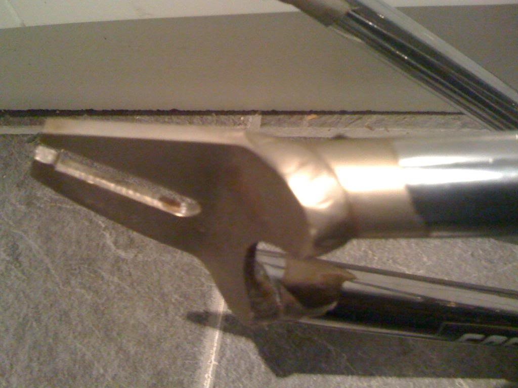

Here's a few pics of the flaking chrome frame

First time i've seen a chrome one of them, i wonder if it's factory?  ???
