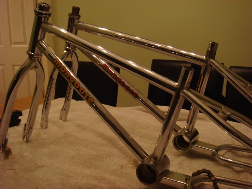

Ok so I already have a Mongoose Californian.......but I picked up another Goose today which I believed to be another Cali
from the description until I got it home and put it next to my original one and realised it was way from being the same.
For a start its a lot smaller and the top tube is a lot thinner...also the frame is a lot shorter.
The brake bridge also has a notch at the bottom.  :idiot2:
Serial number is M4B0469..
Guessing it may be a Minigoose  ::)
Anyone help?

mini  :daumenhoch:

Steve, as Jonnygoose said, it's a Minigoose you have there bud :daumenhoch:
Here's my daughter's done with ProClass paint (I had it at MK with me) - look at the line of the top-tube into the rear looptail, almost straight. I suspect whoever owned it was running skinnies and had the brake bridge ground back for a bit of clearance :coolsmiley:
Nice bike, but un-ridable if you're over 5 foot tall I'd argue, and I know you are bud :-\ Pretty rare though - I'd deffo keep it and your 7-yr old should love it :smitten:
Oh, swap the forks onto the Cali as they are the right ones for it if you're keeping them both :daumenhoch:
Nah.
Same brake bridge on my 84 mini Spen - fairly standard brake bridge on a cali era mini - yours not the same then ? what serial you got ?
Steve as for rare - rare enough but not super rare - rarer than a cali that's for sure  :daumenhoch:

Chro-mo mainframe Steve and with an "M" prefix serial it's made by merida in Taiwan.
Standard 20" parts for the majority components mate - they did a hi spec and low spec though. The hi spec had 1 3/8" skinny pro-class rims and Lee-Chi/Pro-class caliper brakes - the lower spec had coaster brake 1.75" steel pro-class rims.
The bars are smaller and are specific to this and the 16" mity of the same era. Can sort you a pic if need be or check out my 16" mity in my bikes thread.
Other than that it's pretty much cali/expert components - BMX aero seat (viscount), SR 468 pedals, mongoose grips, MX hinged clamp, cheng shin comps etc.
