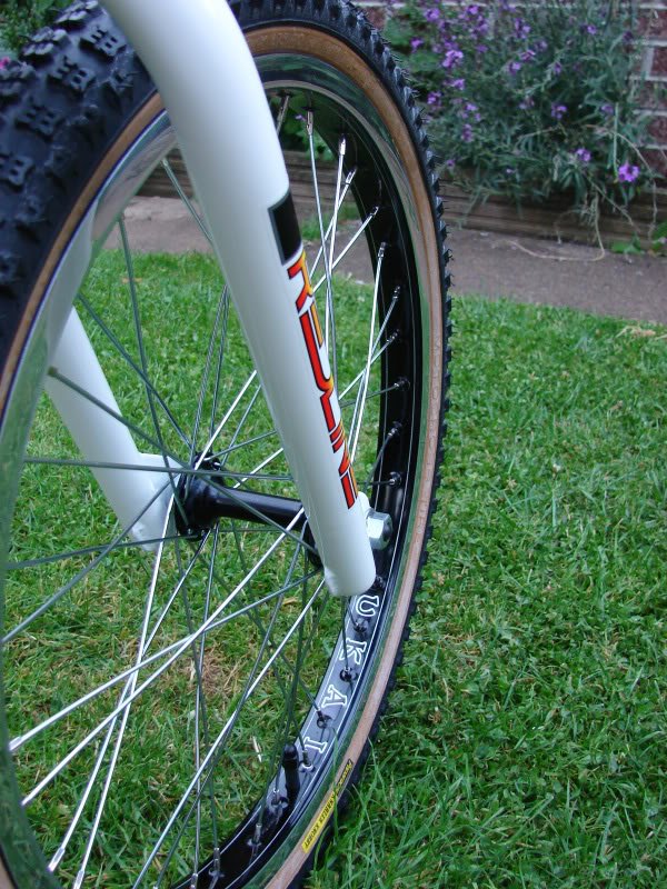

that would be me ,,,the gay pensioner ,,,its alright a certain mod has changed it so that if you type my name the gay pensioner comes up  :2gunsfiring_v1:
when i had mine done by cc ,,the line was what i had to sort out ,,as said they are silver ,,reckon they machined the line in after the anno had been done bitd
i bought a silver paint pen ,,,look on ebay they do all different size tips ,,,think i used a 3mm tip
went around the line with the pen ,,, then wiped the excess of lightly trying  not to go into the speedline with nail varnish remover ,,,, which is acetone ,, didnt try neat acetone
but went with the nail varnish remover as its diluted
heres the result
