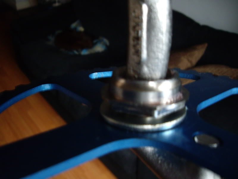

i'll try to explain this as best i can.  i bought a mongoose crank to replace the generic one i have on my cali.  i took it apart and when i started fitting the chain wheel on to the new crank, the nut didnt do up fully - there is one washer/spacer, but it seems on this crank i'd need two of them to make up the space .  i checked the bottom bracket packet which i'd kept and there is no extra washer.  am i right in thinking it just needs another washer, and can i just purchase one of those?

no, afraid this isnt a goose bb - here is the pic - you'll see the space - it's like the threaded bit on the crank doesnt go down far enough to enable the nut to tighten up completely

Looks to me like that is the wrong nut buddy
not an old school type from all the ones ive fitted
it should have a recess on the flat side of about 1/2 cm if that makes sense to ya as thats what clears the gap

ahhhh, right - i see - in that case, i need to buy another bottom bracket - cool, at least i now know where im going wrong
