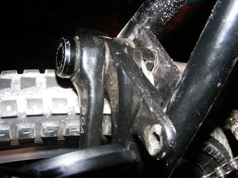

11mm drill bit
dirt bike brake slot for 6mm spindle
drill in position
hole drilled brake installed 5 minutes later

« Reply #16 on: February 20, 2011, 08:46 AM »
 :'( owwwww poor frame.i could.nt drill a frame out just for a brake.ouchhhh

The dirt bike deserves no sympathy.  :LolLolLolLol:
but a brake that works far outweighs damage that can be done from a flipped manual  :daumenhoch:
