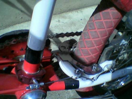

Heres something i made in the late 90's.
Worked really well.
Worked really well.
Hey, Ive just made something very similar to that. Im going to give it ago soon, at the same time as putting a gyro on (for the first time in a few years).
Worked really well.
I made something like that years ago too, but mine was more like a wider brake b'stard/london mod though, bolted through the seattube hole, long ago when brakes were on the chainstays  :LolLolLolLol:
