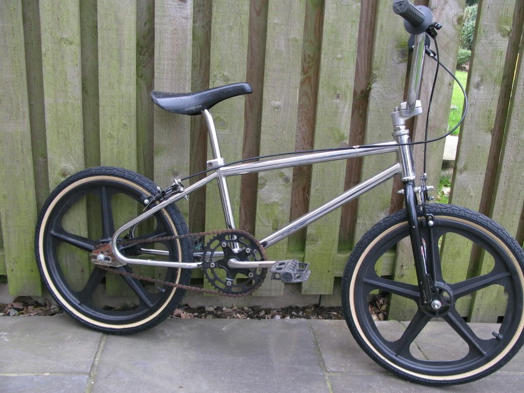

I sold the Cali that you saw Spen and also did another one. It was in the resto thread last year, it started off as a green m1 and ended up a white version of my chrome one. I sold that too and whilst I would love to do another one this year, lack of time and money is probably going to prevent it. I still enjoy seeing how it should be done on here and do get very tempted. See you still can't shake the old mongoose bug off hey? It's looking good
