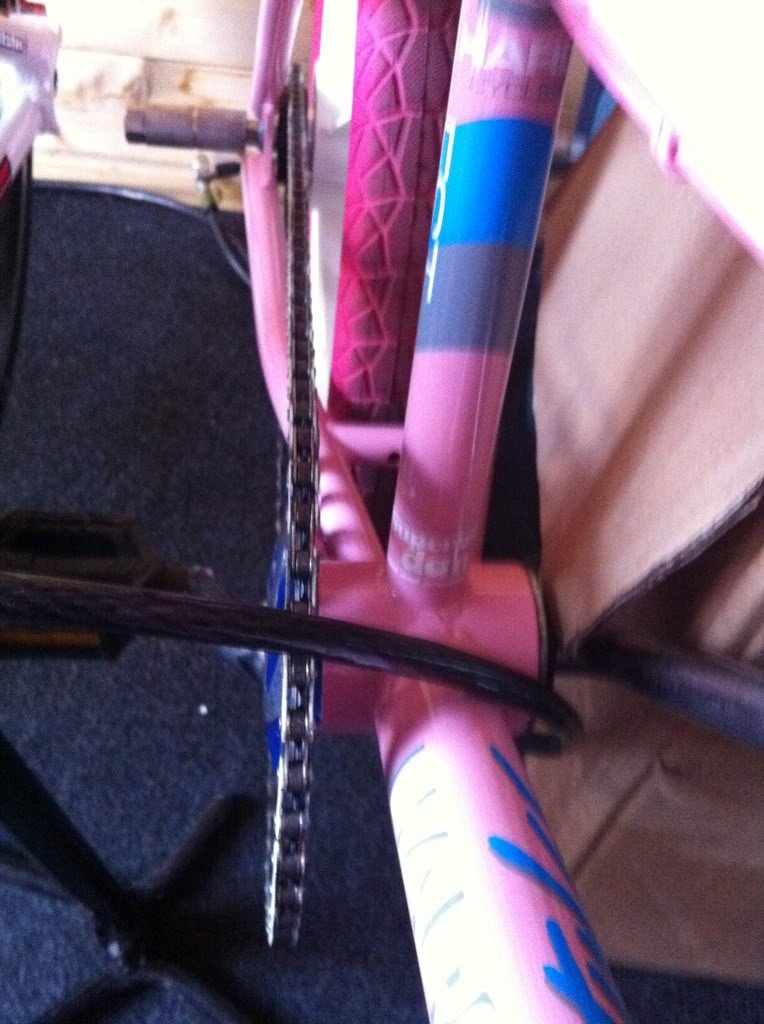

yeah.......get your camera and take a picture of your chain line from the back and you should see if it's out of line or not? bang it up so we can see

Its not the best picture as I am at work at the moment, the chain wheel is on the outside of the spider (is this correct)

I think that the chain is too wide, lots of latteral play, it all looks in line though
Re: A chain in the Ar$€
« Reply #16 on: March 25, 2011, 05:49 PM »
yeah the chain looks in line okay, are all the chainring bolts done up tight? there's no wobble in it is there?  maybe it's just your rear wheel slipping?  get some chain tugs  :daumenhoch:

looks like you running a 1/8 chain on a 3/32 chain ring mate, that may not be helping as the chain will move side to side as you pedal, if the chain is under tensioned, that could be throwing it off, as it will never stay true between the freewheel and the chain ring.  have you got an 1/8 chain ring you could just throw on  and try.  :daumenhoch:

I have just got a slimmer chain from halfrauds and will give that a try  :daumenhoch:
