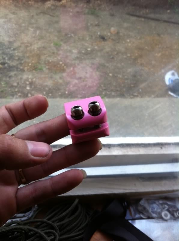

here's a couple of small bits ive just done for the missus in a nice skyway pink !!

They look well sweet, is it best to still go for the dozens of thin coats application rather than a few thicker ones?  I realise the thicker you go in one application, the more chance of a run
