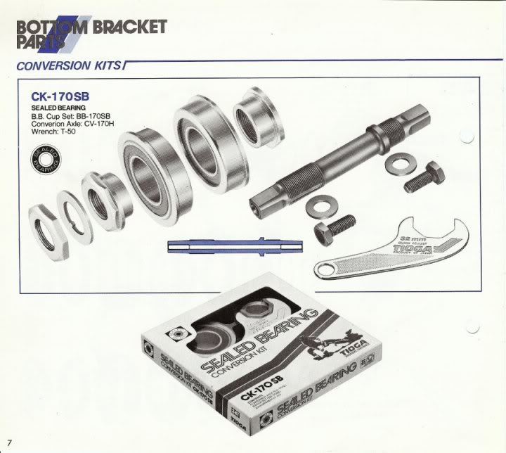

cheers mate for the pic  ;)
do the cups look right for a tioga set ? the rest seem to match or so, but the inside cup edge is not the same - and it still doesn't explain why one of the cups is out by a mill all around ?
cheers B  ;)
monkian
Re: BB info needed - please look and work out !
« Reply #2 on: May 30, 2011, 01:26 PM »
It's one of these B. Got one here all exactly the same except my axle is stamped 83-C & has a little Tange logo (could be a year thing) 8)
Tange also released it in their own branded packaging. Got another CV-170 Axle from a CK-170DX BB Set with no logo or date stamp.
Hope that helps :)
