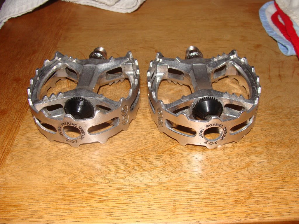

« Reply #13 on: July 30, 2011, 08:11 AM »
and finally from this
to this
Ride it like its stolen
Re: polishing pedal cages
« Reply #14 on: July 30, 2011, 10:51 AM »
good work ;) Not good 4 the fingers tho  :LolLolLolLol: but worth the effort when u c the results  :daumenhoch:
« Reply #15 on: July 30, 2011, 11:40 AM »
well done you got there in the end,i told you its a peice of pesh :daumenhoch:
