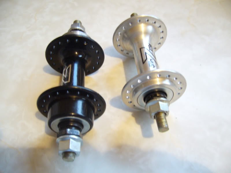

for  low flange acs z hub to z rim is it 194mm??
Re: spoke size?
« Reply #1 on: November 24, 2011, 02:26 PM »
depends on the Z hub you have???
Shoud be 184's though for the Larger flange hubs and 194's for Suzue small flange using a lace 4 pattern :daumenhoch:
Re: spoke size?
« Reply #3 on: November 24, 2011, 02:43 PM »
Are 184,s
Put a pic of your hub up

my hubs:

Re: spoke size?
« Reply #5 on: November 24, 2011, 02:53 PM »
I just done some of these with 194's laced 4 cross

« Reply #7 on: November 24, 2011, 03:02 PM »
194 to suzues build them 2 days ago spokes not remained in photo

« Reply #8 on: November 24, 2011, 03:10 PM »
194 me thinks :daumenhoch:
