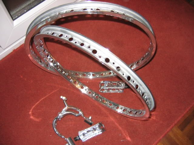

here are some pics to go with above text :daumenhoch:

Bloody heck Sawzall, what did you use to polish those after the dip?

i used a bench polisher,then hand finished with solvo then peek,rims were originally hard annod in grey, now fitted to my completely alloy ripper :daumenhoch:

« Reply #10 on: June 09, 2006, 11:18 PM »
excellent...i know where to send stuff to be done now!  :daumenhoch:

sawsall is the master polisher
that ripper was like glass at epic!!
