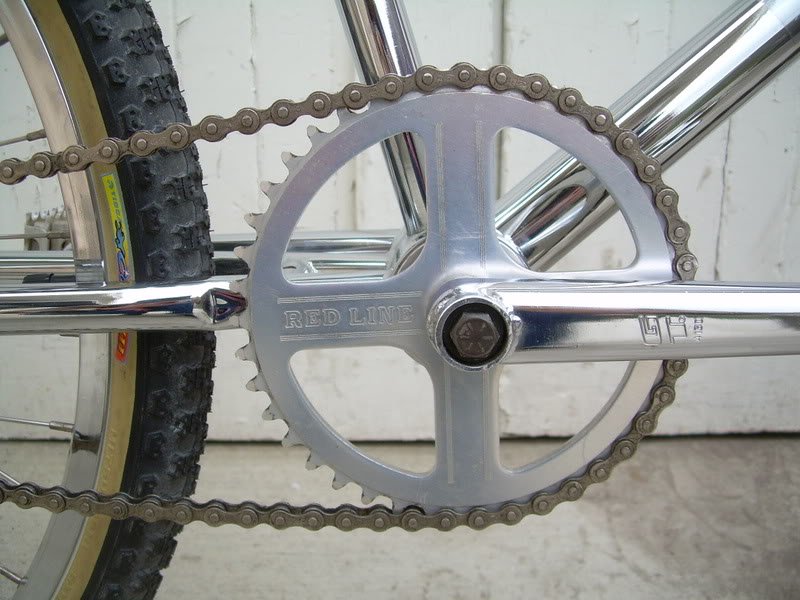

A 44T wont work, that freewheel is either a 17 or an 18 I think? in that case a 17T freewheel would require a 39T (closest to 44/16 on a 20") chainwheel and an 18T would require a 41T. You could go 1 tooth less in each case but the gearing would be lighter (some people do this for faster gates)  44T in either case will be really tough

Coming together nice!
I'm running a 41t sprocket on my Widowmaker and it fits perfys. :daumenhoch:
Leatherman
Re: Widowmaker
« Reply #52 on: February 09, 2012, 10:16 PM »
OK, off to find a 41T sprocket. LOL
Anyone need a 44?

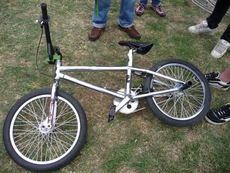

Re: Widowmaker
« Reply #54 on: February 16, 2012, 10:58 AM »
his royal twistedness  :daumenhoch:
« Last Edit: February 16, 2012, 11:02 AM by OrgasmDonor »
Re: Widowmaker
« Reply #55 on: February 16, 2012, 12:48 PM »
Very Metal

I love that pic of Dee, this is pretty much done aside from some red Crupi chain tensioners that are lost in transit.
Damn shame we just got a foot of snow.
Frame: 1994 S&M Widowmaker (serial # SMC 2195)
Fork: Pitchfork
Cranks: 175 Redline 1/2 wraps with sealed bearings and 41T Profile Ripsaw
Wheels: Phil hubs laced to Alex DM22 with Phil spokes and nips and a 17T White Industries free wheel
Tires: Silver label Tioga comp 3
Pedals: Odyssey Triple traps with Crupi cages
Chain: Izumi
Seat: NOS Odyssey Cobra
Seatpost: GT layback
Seatpost clamp: NOS PMC
Brakes: NOS Dia Compe 901 with ACS lever
Stem: S&M Redneck with Wedgie Jackson
Bars: S&M Gay bars
Grips: Jive with nuts
Headset: Odyssey 1" Pro with PMC headlock
