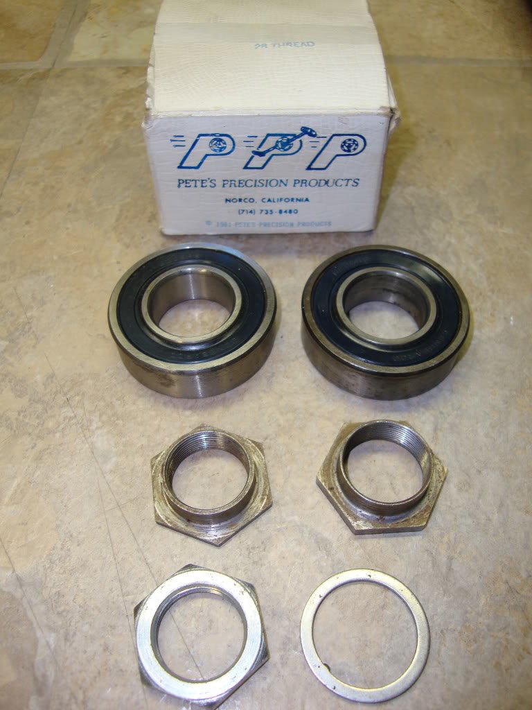

That looks like them, What make is on the rubber seal of the bearing, Mine is GENBEARCO, 6205 is the bearing code.
i got the pic off the museum,the writing looks like Genbearco though :-\
Normal 6205 bearings measure 52,25,15mm
 that wouldnt fit into the bb shell(51.50MM),bit tight,but with some ground off,would be a nice fit,hence the lip :daumenhoch:
Get pics up :D

Yep you have a PPP  bottom bracket there,i had one exactly the same,blue seals the lot,custom bearings so clean up and put back on :daumenhoch:
Not many of these about :daumenhoch:
