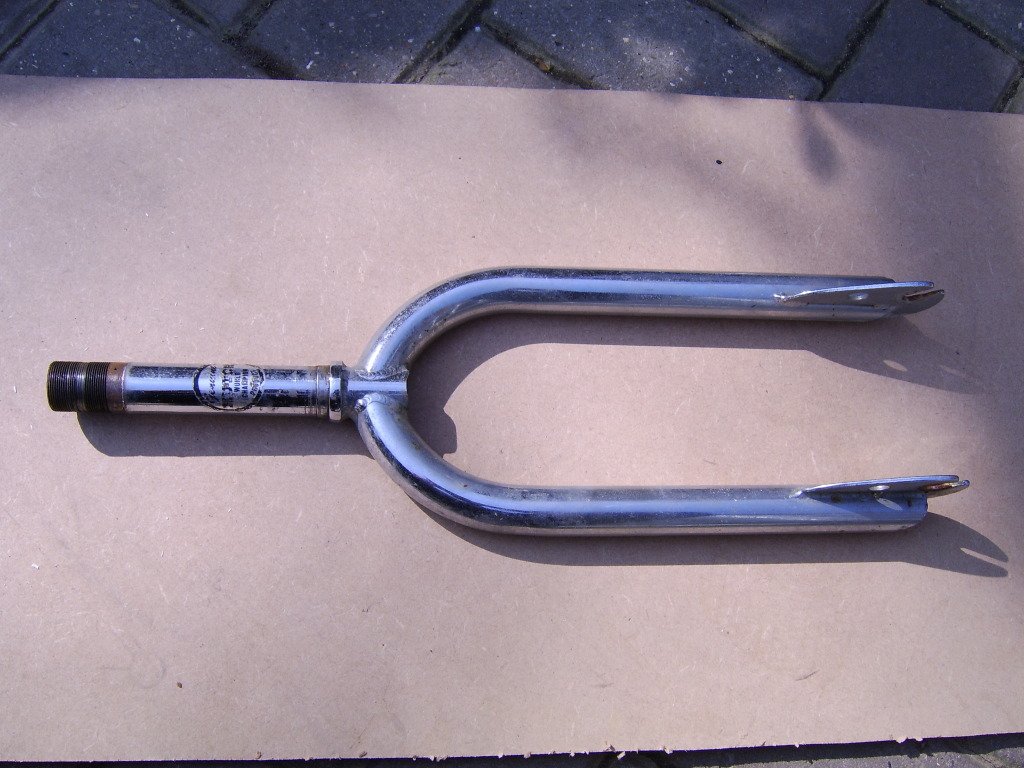

Re: 1" threaded forks , stripped thread . Can it be fixed ?
« Reply #7 on: March 23, 2012, 03:52 PM »
Here`s a pic:
Whether they are rare or not , I`m sure one of you guys will know ; I think they are from 83-84 from a Hutch Expert .
« Reply #8 on: March 23, 2012, 06:45 PM »
non drilled....yumee.
doctor-46
« Reply #9 on: March 23, 2012, 07:38 PM »
looks like there's plenty of thread higher up to try the spacer suggestion by 750 rush.
« Reply #10 on: March 23, 2012, 09:46 PM »
looks similar to the damage i had on mine. are you coming on the london ride? if i get my tool back off of andy il bring it with me  :)
