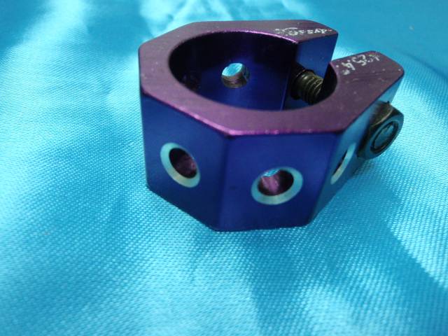

I've got some 990 mount forks, just wondering if i removed the mounts and spaced them further apart ( about 5mm further away from the rim, so 10 mm in total) would the brakes still work well enough to use  :daumenhoch:

Just got in from work and mine measure 85mm so i guess its not too critical but yes, the arms hitting each other before the brakes kicked in was my main worry.
Sounds daft i know but im looking to mount two of these:
On my WTP brakeless forks and bore & tap out one of the holes to accept cut down, bolt on, 990 mounts.
I dont really want to replace the forks or drill them for a caliper brake and want the stopping power of 990 brakes.
The Oddy clamps will result in the mounts being central on the width of the fork tubes, hence my original question.
May even incorporate some small fold up standers on the seat clamp bolt if i can arsed  ;)
