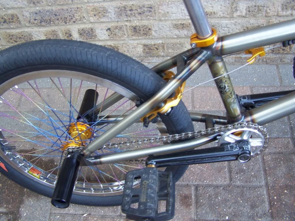

my profile ss freecoaster with nankai custom bamboo internals.ti axle and clutch with ceramic bearings ala rob ridges workshop.
