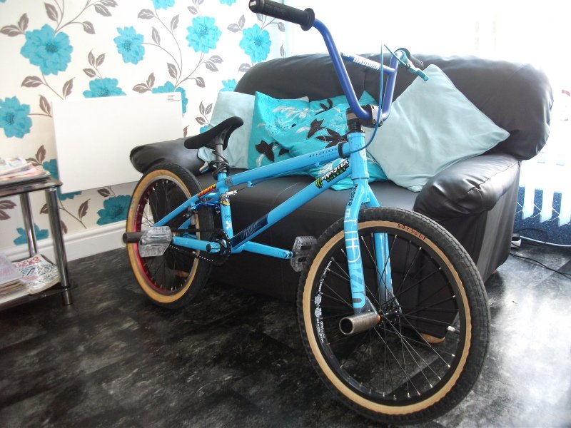

I think i want to put a giro on my KHE Maceto, being a new school I have no idea whats what, it has holes for removable tabs, so what about the rest? do i just need a regular giro system?
Links etc for whats needed, would help muchly :daumenhoch:
Thanks in advance

First thing to do is check to see if the steerer tube is going to be long enough to run a gyro setup, stick a pic up  :daumenhoch:

Don't think space is an issue, 2 spacers under the stem and one on top. :daumenhoch:

u will need the following, there other versions out there like the odyssey gtx etc...
snafu mobeus gyro  http://www.customriders.com/prodshow.asp?prodid=6771&cat=19&parent=1001&sidehop=3
then a gyro plate if your stem dosent have gyro tabs http://www.customriders.com/prodshow.asp?prodid=14686&cat=19&parent=1001&sidehop=3
then a odyssey m2 lever a cable http://www.customriders.com/prodshow.asp?prodid=7948&cat=27&parent=1001&sidehop=3
then a dual lower cable http://www.customriders.com/prodshow.asp?prodid=14685&cat=14&parent=1001&sidehop=3
u can use ur existing lever with a normal upper gyro cable but the m2 set up works very well

Yep, Loads of room, buy that setup off Bendy it's a good deal  :daumenhoch:

Thankyou Bendy, arrived this morning, fitted pretty easily and set up 2nd time round, don't know why you had so much trouble with this  :LolLolLolLol: :smitten:
No more flappy Linear cable  :daumenhoch: But do have to get used to using right hand brake again :D
