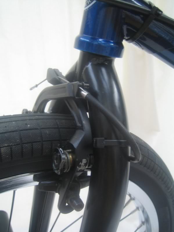

can someone show me some pics how the cable goes into a u brake to use as fron brake etc ?
only got one barrel thingy but the caliper def says front or rear on box.

Depends how fancy you want to get mate.
I've simply jammed my cable into the brake mid school style. All you need then is a knarp for t'other end. It's not the most sophisticated setup but it works.

THIS IS WHAT I DONE TO BE HONEST LOOKS BIT SHIT BUT WORKS ,thought there would be adjuster for one side and knarp other being front or rear .works okay for what i need just fancied a front brake at bones saturday for change

You dont need an adjuster on the brake cos there is one on the lever. Keep it clean and tidy, nice short cable.  :daumenhoch:

You can get these Greg, I know the other ways work, but this is the easiest way  :daumenhoch:

This is it done using the adjuster that comes with the ad990's, the odyssey one is much neater.

I agree it works spot on.
I put it on having run it without first using just the knarps, that was a pain the the arse to adjust especially with a new cable that was stretching.
Although neater I read somewhere the odyssey one doesn't fit I thought about getting one and modding it but couldn't be bothered.

you dont need owt but the cable to fit in the 'adjuster' arm. i been running mine like this for years with no problems and i ride flatland so constantly using my brakes
