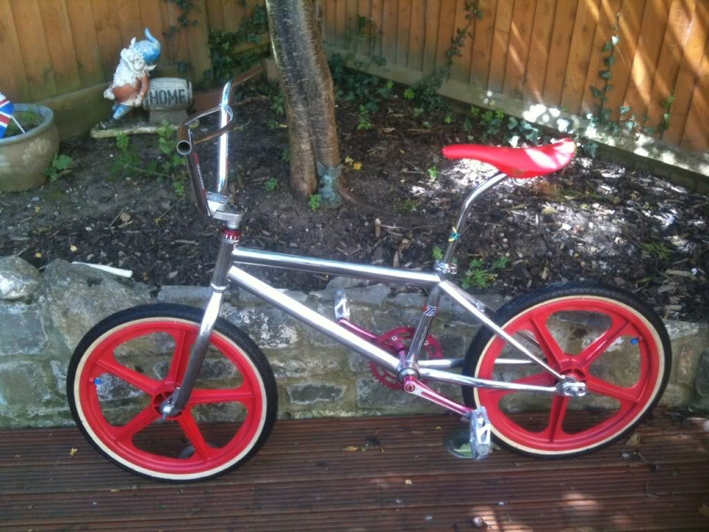

Hi all, have finally bought everything for my skyway T/A build, and already stuck on the wheels lol. They are the new released skyways, and first axle wont fit into forks, and if it did looks like there will be a huge gap either side to the forks, whats going wrong  :'(

You'll need to file flat spots on the axle then use dropout savers  :daumenhoch:

as this ..
here are samples of axles ..if i am understanding your problem as that the axles and forks will not marry .
note the different shafts ..in early set forks many required a flat sided axle
what i have done which may help you is either change your axles or b- run a 4 inch grinder carefully over then whilst nuts are on them .
after your cut grease the shaft then remove those nuts cleaning threads .
in the case of your gapping .i suggest adding 3/8 or 10mm washers or teflon auto washers ..you may only require at most one either inner side.

As Snav says, just use a small file and file the threads flat where the fork dropouts hit the axle  :daumenhoch:

« Reply #9 on: July 28, 2012, 02:38 PM »
Packed evenly either side, and only had to grind smallest part of thread  :)

Re: Fitting new skyways to T/A forks
« Reply #11 on: July 28, 2012, 03:45 PM »
Nice TA  8)

........... as an option you can always buy these flat axle converters, link below.  :-\

« Reply #14 on: July 28, 2012, 06:57 PM »
Think I may go with that option, as the axle is far too long, thanks for the link  :)

« Reply #15 on: July 29, 2012, 07:04 PM »
I went the winstanleys route, I think the front axle was about £5 posted, a 2 min job to install & looks a lot better than some bodged filing job, oh & the new axles are the right length, for some strange reason, new skyway axles semm to be about 3 feet long! :wtf:
