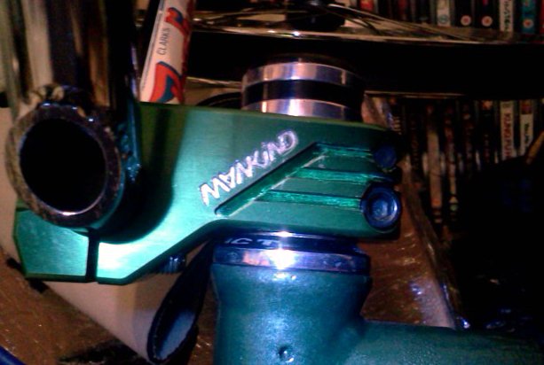

Would it be a problem fitting a stem so it sits on top of the headset without any spacers?? I cant think of a reason but cant recall seeing it done.  :-\

Top loader so all should be good.
So long as you have the top part of the headset (the bit that the bearings sit against) then all's good - I run without spacers (although at the mo I've got one small one as I have a front load stem).

With a top loader you'll be fine, might wanna chop the steerer down if you don't want spacers on top of the stem

on a 1 1/8 ?    the black n chrome bit under the stem is one piece ie the the top cap ,with a 1mm steel washer/ spacer,   but if the compression wedge sits above the frame when compressed then can see no reason why the top cap and washer can't be left out ,  aside from leaving the bearing exposed, if its a sealed bearing then no probs , semi sealed you'd just have to watch for dirt getting in .

Yep it's for the gingemobile Jim. I'll be leaving the topcap on. I could turn the stem upside down but dont like the look of it. Your pic has answered my question :daumenhoch:

It's perfectly sound to run your stem ontop of an internal headset without the top cap.
As long as you've got the compression ring in there.
I run my BSD race stem straight on top of my internal headset to get the 8.6 bars just the right height.
