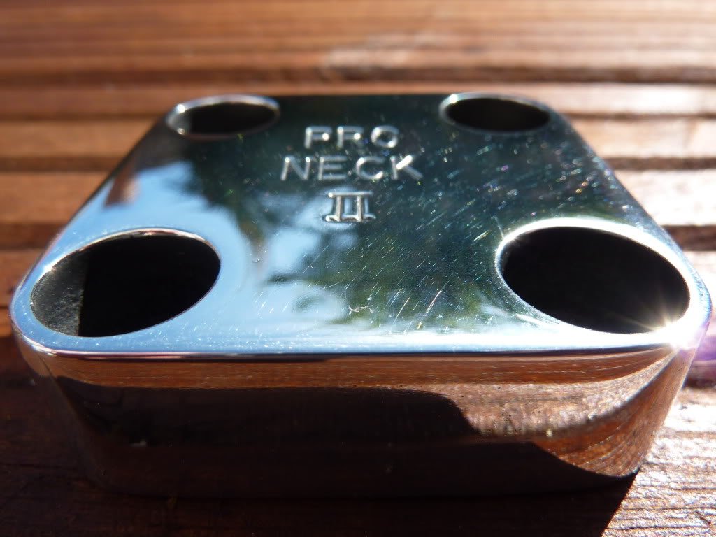

This is what my Pro Neck II looking like after i left it in Oven Pride for 4 hours  :uglystupid2:
and after bout 8 hours polishing the fook out of it  :daumenhoch:

That's the finish I'm after jamroll,what did you use to get it like that? :daumenhoch:
It was Anno, hence the oven pride, then some wet and dry to get all that shite off it, if you rub the over pride through the bag if your parts are anno it will come off straight away and not go like mine did, then get some polishing clay and a drill mop and go to town, if the Anno comes straight off, a light polish will having it looking like mine in a hour or so....
Mine was pitted to fook as the Oven Pride ate the alloy  :( but plenty of time got me to a shiny finish.

Thats a great finish! I have to admit....it does take a while to polish bits up!
