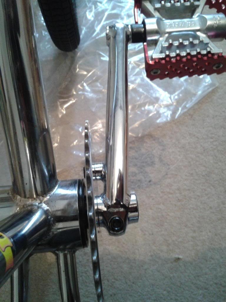

Got some more crank arms today. They're NOS chrome ones off a Haro 500.1.
I'm not quite sure on them at the moment.  :-\
They're not as chunky as the other ones and I quite like the polished alloy look of the others too (which also took ages to do!). However, this is going to be a rider and the non-drive side arm on the other cranks was worn and loose, so I had to change them. The only other problem is they make the pedal look massive now but I'm sure I'll get used to it!  :LolLolLolLol:

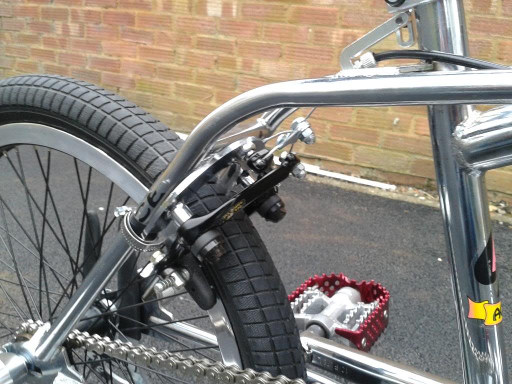

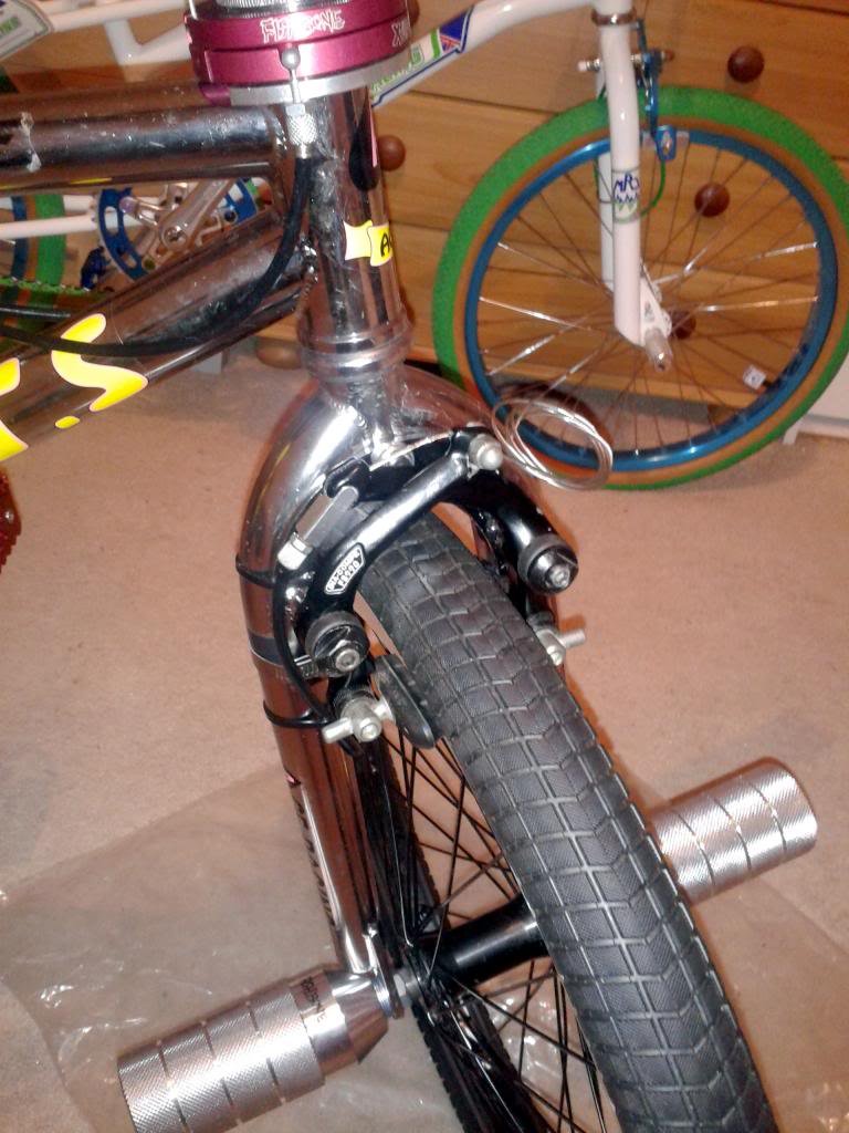

As I intend to use this for a bit of flatland too, I thought I better improve the braking. I picked up  a set of AD990 and FS990 calipers and ordered a Fishbone U-brake plate which came through today. It's a really nice bit of kit and fits great. The only trouble was I had to leave off the outer bracing plate with the logo on (don't think it needs it anyway) as it fouled the pinch bolt. I think it's a great period touch from before the time most forks had 990 lugs. I've orded another one for the rear (had to make sure it fitted before ordering two) although I'm now going to have to buy a Pozi-Stop to get it working properly!  ;)

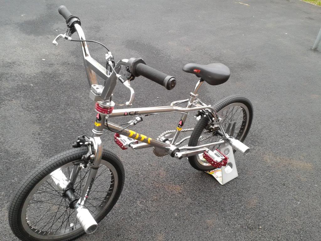

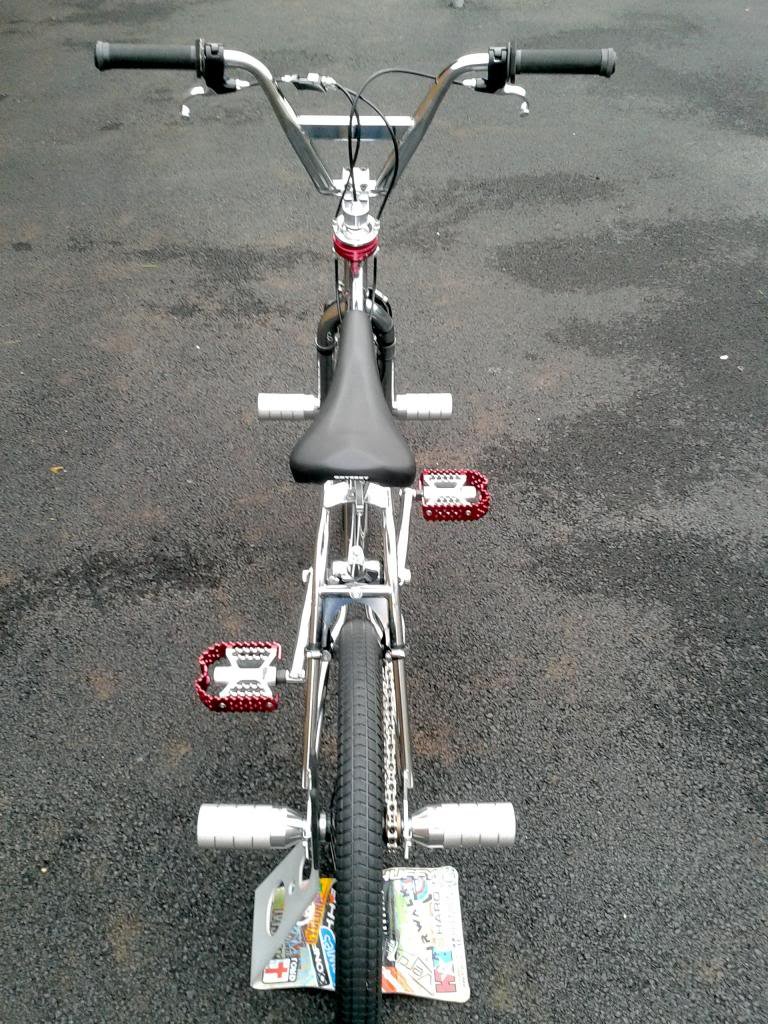

Finally got the last pieces through to finish her off!  :daumenhoch:
After finding out the Fishbone 990 plate would fit on the rear too I ordered another one and figured out how I'd set it up. Originally, I was going to put an Odyssey Pozi-Stop seat clamp on and run the cable through that to the 990. Then I suddenly thought I don't need to and I could keep my nice, chunky Fishbone seat clamp. If I put a cable adjuster through the cable loop on the underside of the top tube, I could just run the cable from there to the straddle cable if I looped it around the seat tube. It all seamed to go realy well untill I went to connect everything up then realised the brake was at completely the wrong angle for it to work! Back to plan A then!
Finally got it all set up and had just enough light left to get some pics outside. I wanted a bike I could do some flatland as well as light park stuff on and I'm really pleased with how she's turned out. Nice and chunky in the best mid-school way!  :LolLolLolLol:
Hope you like her..............
