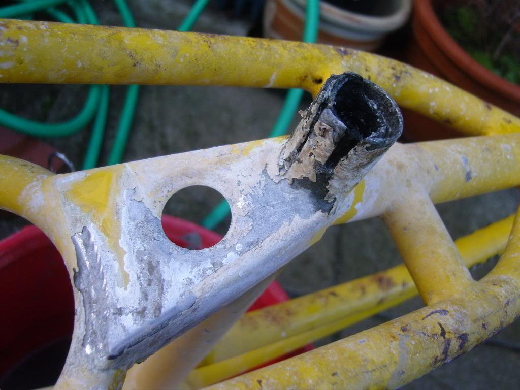

My stuck post wasa alloy renthal and it has fused to the metal frame - snapped the top trying to drill a hole in it to twist the top (it was fused)
if it has moved 3 mm then i would put it in a vice and twist it out using some man power  :knuppel2:
got it out in the end - just got to get it welded up from the previous owner
