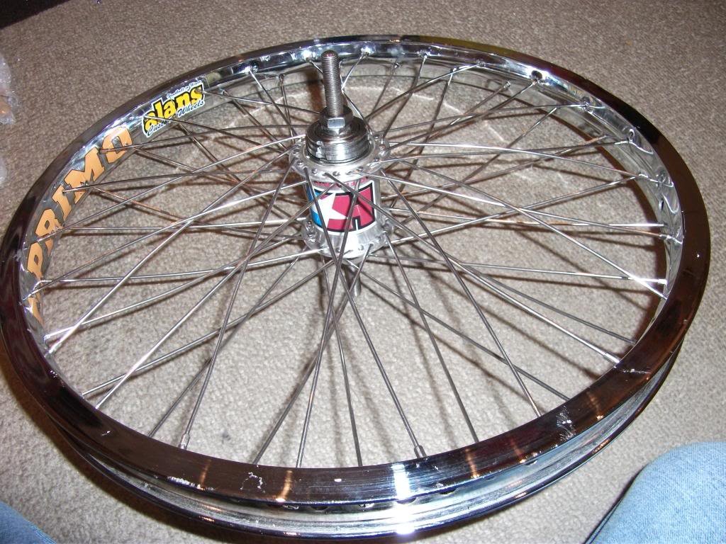

got this rim for a £1 on the bay, so decided to lace it up, i knew the spokes would be too long but gave it a go, pleased with the result. will be using the sticky on here when i eventually do it

I see you have done a 3 cross pattern, the spokes might be long enough for a 4 spoke cross :daumenhoch:

yeah cheers nick, worth a go. do you do do you count 3 and go under the 4th spoke?

yes, exactly that :daumenhoch:

tidy i'm off to take it apart :daumenhoch:

great job :daumenhoch:   very therapeutic building wheels  :daumenhoch:  great when you true em up ride em a bit then tweek em a bit just knocked these up ready for some summer fun  :daumenhoch:
this may help there's few on the net but this one is pretty easy to get to grips with, good help files  :daumenhoch:
http://www.bikeschool.com/tools/spoke-length-calculator

Top job Garran! And that rim was a bargain!  :daumenhoch:

did a 4 cross patten , it was better but the spokes are still too long, might eventually put the hub on those arayas i had off you Gav, good fun and good practice :daumenhoch:
