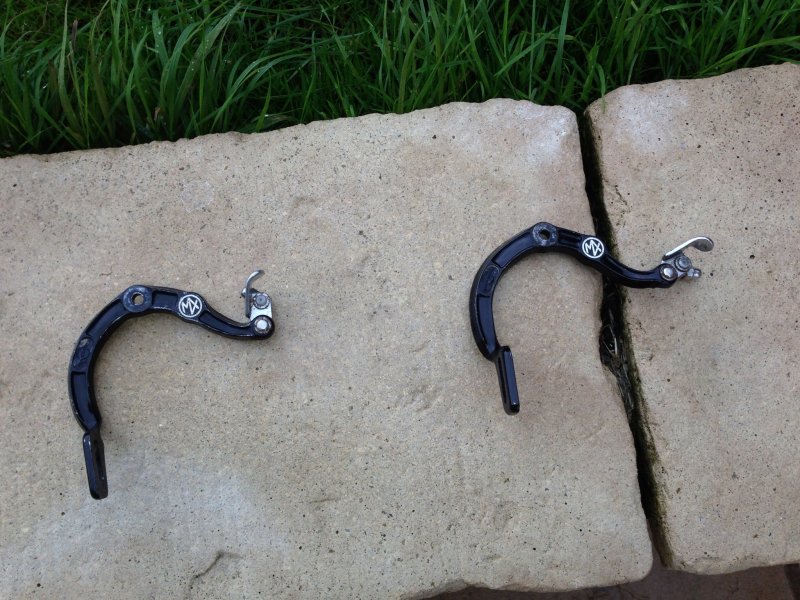

I've had em sat in nitromors for a few days and its not touched it !
Are they anodised black ? Is it an oven pride job ?

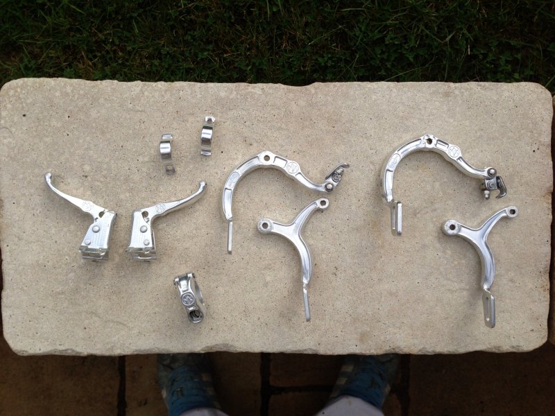

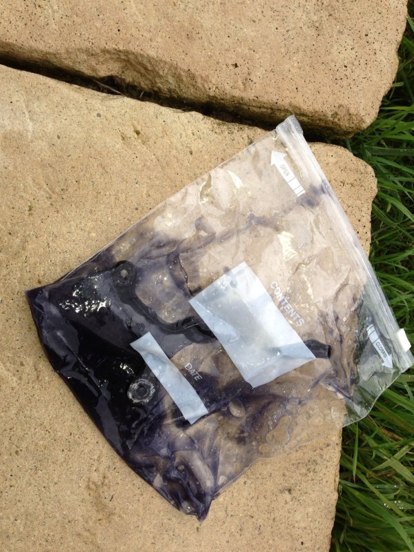

Job done
I used the oven pride in a plastic sandwich bag method ,
Basically I poured some oven pride in bag shoved the arms in for a few minutes rubbing them through the bag , then I fished em out and put them straight into a bucket of soapy water ,
Any black bits I missed I used a toothbrush dipped in the OP to clean the last few bits off ,
All the bits in the pics below were black and this is how they came out , I haven't even polished em
It comes out of the ground!
