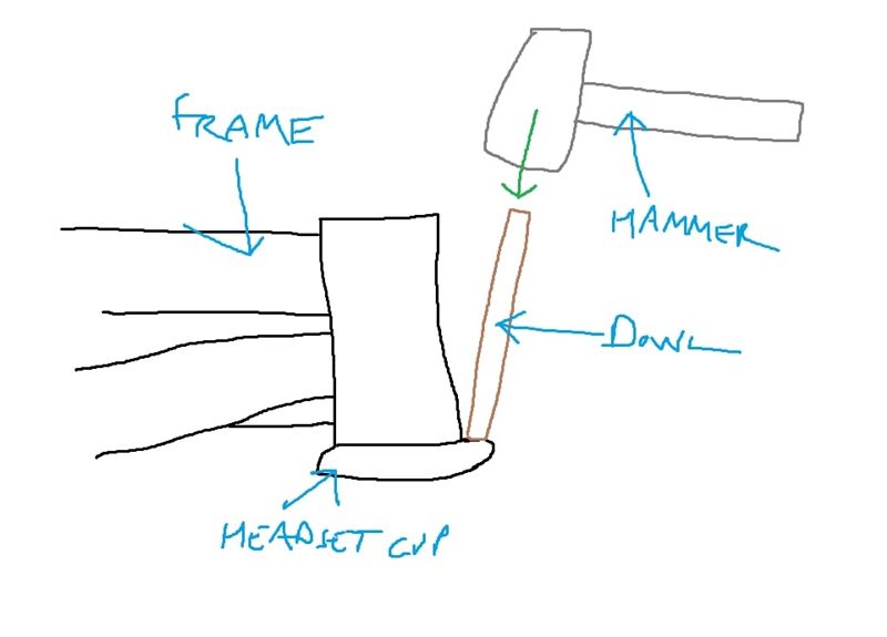

Here's an expertly drawn tech diagram of what to do Dave - guaranteed not to distort your headset:

99.9% mid-school headsets = steel (or heavier metal)  :LolLolLolLol:
, I don't know what their made of , i'm still back in 1979  :LolLolLolLol:
If the cups are the same shape as the one in the picture, I can see why they need replacing  :LolLolLolLol:

Top man Danny mate.
Done the job spot on with a bit of wood.
Never thought to look how deep the head set cups were before.
This was way out when I looked after.
Ended up knocking a primo one in and that's done the job.
Ya learn something every day lol.
