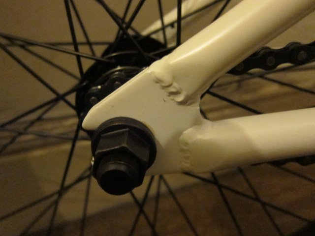

Just wondered if i might be able to get some opinions on this. If im concerning myself unnecessarily then please forgive me, it's been a long while since i've owned a BMX. I opted for a discounted 2012 complete, i can see it's built to a price point but the welding on the rear triangle one side doesn't look too clever to me.
Any thoughts? Or should i just crack on  :-\

Fookin shocking bit of welding up top there, but unless you're gonna go big and a lot I wouldn't worry  :daumenhoch:

I'm no welding expert, but I can see why you mentioned it, does look a bit rough
Whether it's a problem or not is another matter, someone will probably be along shortly with a more informed view.....

Thanks for the feedback. The tubing looks to have been cut on an angle making it short on the topside (looking from the side), compensated by stuffing a load of weld in it. I'm a bit pi$$ed off tell you the truth, took me awhile to get the money together. The rest of the bikes pretty good but that jumped out straight away. FWIW it's a Cult bike, opted for it because it seemed the best i could stretch too moneywise.

S' the only problem with buying completes that come in under a certain amount to be honest fella. To be fair it looks like they snip and flatten the bottom of the stays to slide the drops in and weld up, so that's probably what they all look like.
Looks a bit crap but you're still more likely to tear the headtube off - the rear T's quite a strong design even with that weldy-balls-up :)

If you're not happy with it, phone the place up and see if they'll swap it?
Ugly weld that.

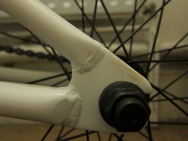

I'm really best guided by people on here ref the welding - a lot more clued up than i am looking around the forum. I have had a few bikes previously, not BMX's but enough to know it's a right Friday weld on this. Other side is a lot cleaner by comparison.

looks like that tube has been blown out with the welder , ie the tube has been burnt away , and the hole has been filled with weld/filler metal ,  i would say that it will more than likely fail/break,
 i'd take it back and ask for an exchange with an inspection of the replacement before accepting it , or ask for your money back ,
item is poor quality and not fit for purpose ,regardless of how much you paid for it .
