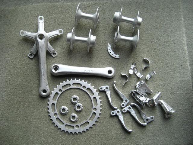

just food 4 thought 4 peeps. I have always stripped with caustic as bitd. Then I discovered 2 my annoyance that some of the annodising remains in place that the naked eye can't c  :knuppel2: This cost me in that I polished a load of stuff took it 4 anno. when I picked it up some was dull not shiny as it should b. He said he had 2 restrip some stuff as anno was still present. Just thought u might like 2 know what I have gleaned 2 save urselves hastle . He stripped all this in ten mins as I waited. Cost me £20 and a lot of time stripping and dealing with the crappy residue caustic/oven pride leaves that is also toxic .
Oh the snapped and cracked hubs r Suntour High flange sealed if u were wondering why I would bother . They r gonna b fixed up  8)

takes a load of hard work out of the job doesn't it... :daumenhoch:
what you gona do with the suntour hubs when they are fixed up?   polish?

Nice  :) what's his anodising like , the finished product
As need some crank arms doing  ;)

niiice ........ can't wait to see the reflange :D

Sometimes the right "tool for the job" is the best way to go, even if it does cost a little more. Yep im interested to see what you do with that hub  :daumenhoch:
