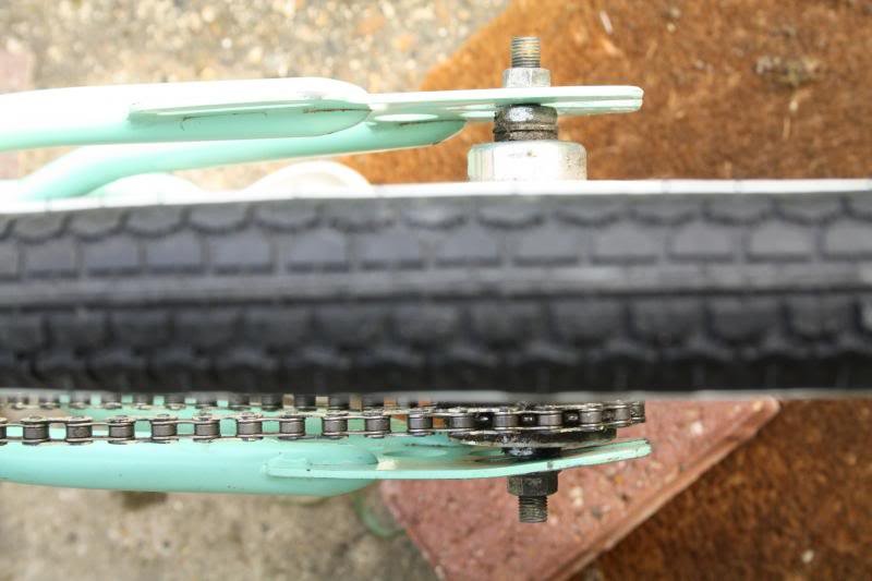

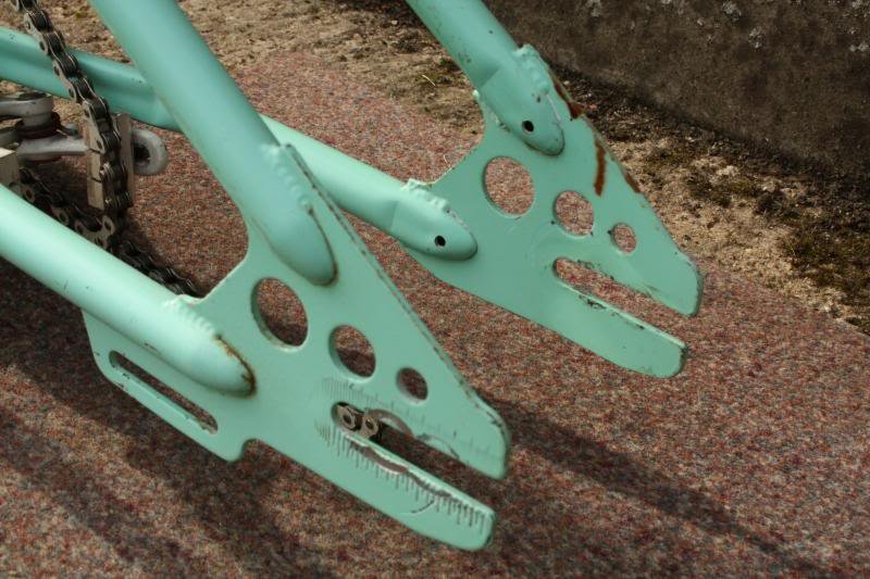

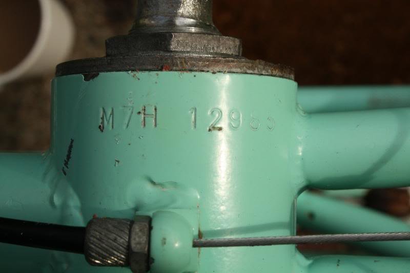

The only bit of damage i can see on the frame unfortunately, is a bent rear drop out:
i118.photobucket.com/albums/o114/lowback/IMG_4868_zps0a4a44a3.jpg[/IMG][/URL]
Any suggestions on how to fix this? will a vice and a bit of brute force work, or will i need to heat it up and use a different technique? If you look at the inside of the chainstay tubing, the tubes are flat leading to the drop out, but only on the sprocket side.  Is this normal, or is it damage?

Yeah its an '87  :daumenhoch:
Dropout is easy to sort, couple of bits of protection either side and slip a large adjustable spanner over the end, tighten it up to grip, and bend back  :daumenhoch:
Offline fischflo
  • Posts: 3865
Re: Project 3- 1987? Mongoose Decade
« Reply #2 on: April 12, 2014, 11:11 AM »
This 1987  has it flat, too, so i guess it's like that http://bmxmuseum.com/forums/viewtopic.php?pid=3481224
animalic Steve
Use 2 blocks of wood in a vice 2 straighten that  :daumenhoch: If u try just bending it cold it may snap  ;)
think i'd try without the heat incase you want to keep the surivor mint  and i'd use a miami vice too :D
edit: the adjustable spanner trick sounds tops :slayer:

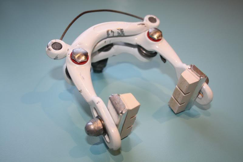

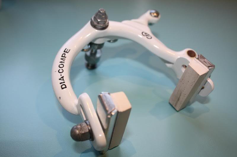

Can anyone tell me what brakes are on it? Are they Tech 5 Levers, with an 880 front caliper? What's the rear?
Offline skippyg
  • Posts: 143
« Reply #6 on: April 12, 2014, 08:59 PM »
dia compe 750 centre pull brake on the rear,thats what mine had on it
Offline insectbones
  • Posts: 1673
« Reply #7 on: April 15, 2014, 05:58 AM »
Yep  :daumenhoch:

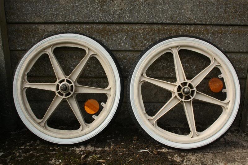

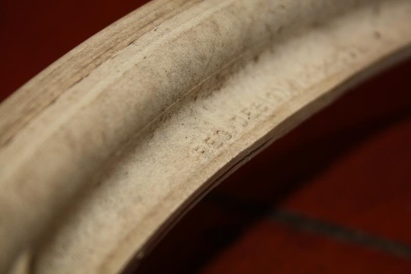

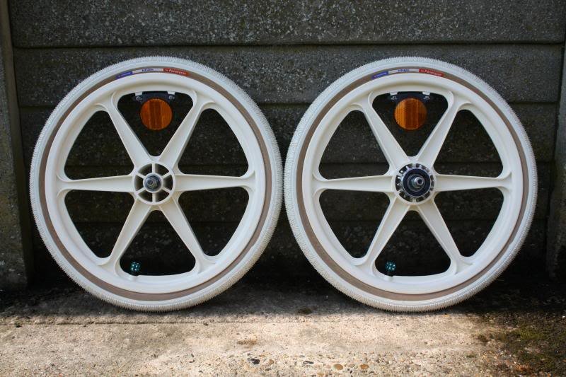

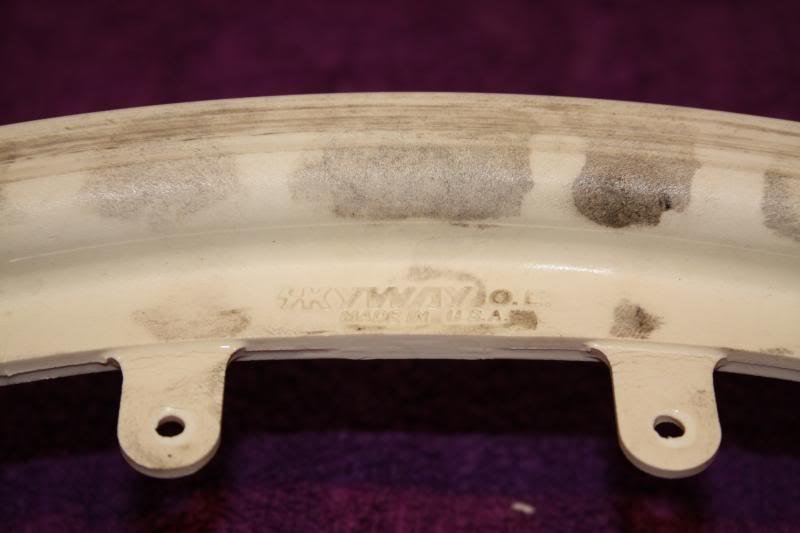

I made the most of the sunny afternoon we are having and decided to make a start on the bike.  I have completely stripped it, and was surprised how easily it came apart.  Everything is still perfectly serviceable, apart from the freewheel and brake cables, so i shall be cleaning them up and re-using everything else :)

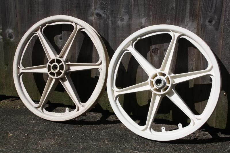

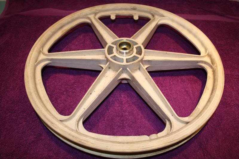

I decided to make a start on the wheels today.  They are the original Skyway OE's, and as you can see, they were yellowed and very dirty. I didn't hold out much hope of getting them white again!
Before:
I had read various threads about whitening Tuffs, most of which involved the use of a bathroom cleaner containing bleach, and then some form of peroxide solution.  This is the route i have decided to take in the hope of getting mine white again.
I used Ciillt Bang with bleach, and some cream cleaner to remove the brake rub:
During:
The above photo shows how well the Cillit Bang lifts off the dirt without any scrubbing.
After:
One wheel cleaned, the other still to do:
Quite pleased with them!  I have ordered some peroxide gel, which i shall hopefully be using at the weekend.  Watch this space for the finished results :daumenhoch:

They came up really well, nice work  :daumenhoch:

Yep, pretty pleased with them. Just finished the front, it's just as good.  Im debating whether to peroxide them or not. They will be true white, rather than off white if i do. I wonder whether to leave them as they are, considering it's a survivor?
Offline insectbones
  • Posts: 1673
Re: Project 3- 1987 Mongoose Decade
« Reply #13 on: April 16, 2014, 03:31 PM »
If you're leaving the f+f and bars as is, personally I would leave the wheels alone now  :daumenhoch:

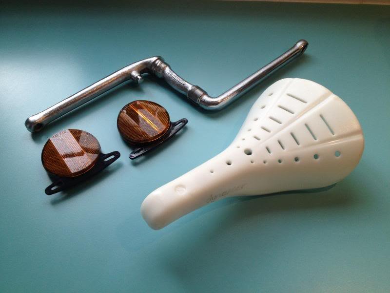

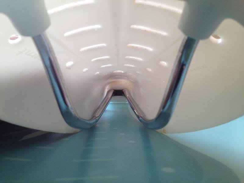

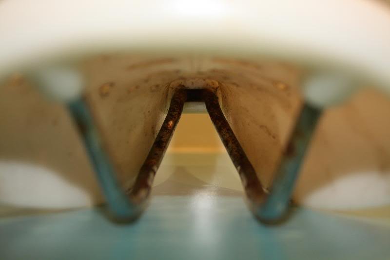

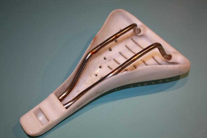

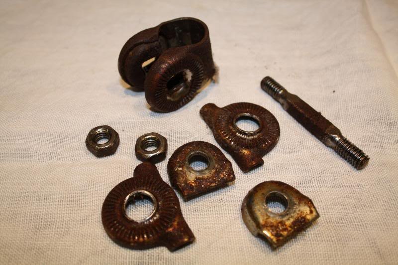

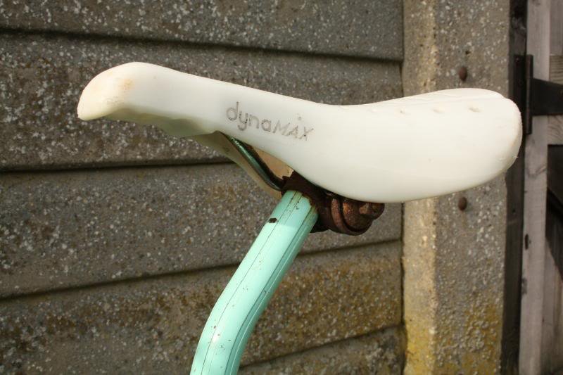

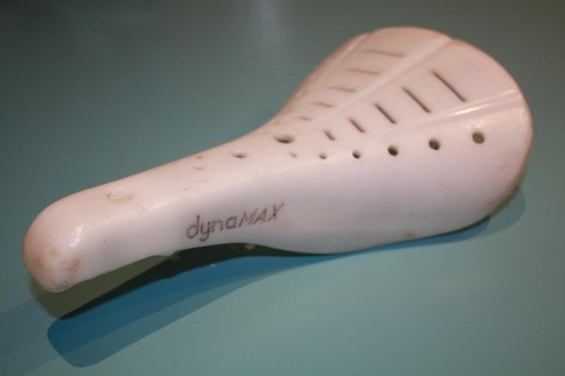

Scabby old seat:

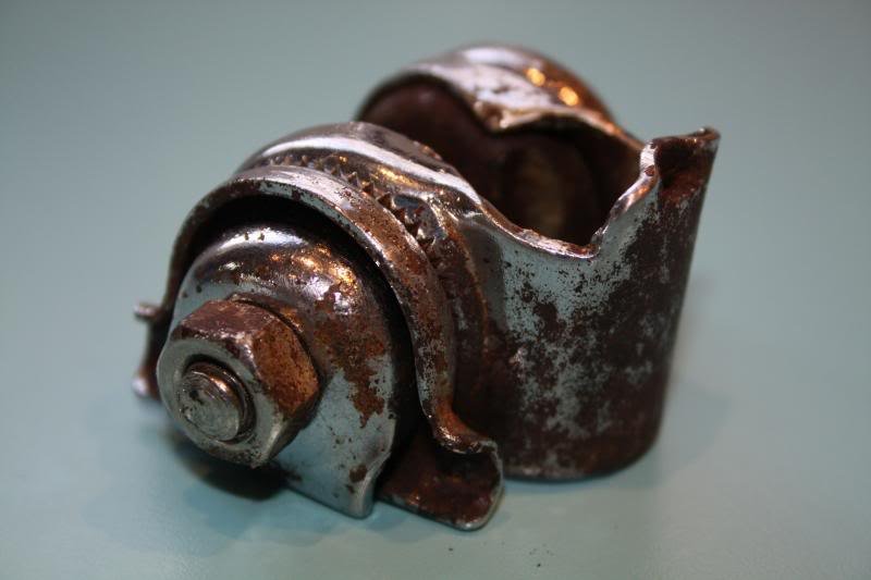

Bleached and then chucked in an OA bath, along with the cranks and some very rusty seat guts:
Result:
Seat guts before OA Bath:
After the OA Bath:
Although still a bit rusty, I think i will use them.  It's a survivor and they are original to the bike afterall!

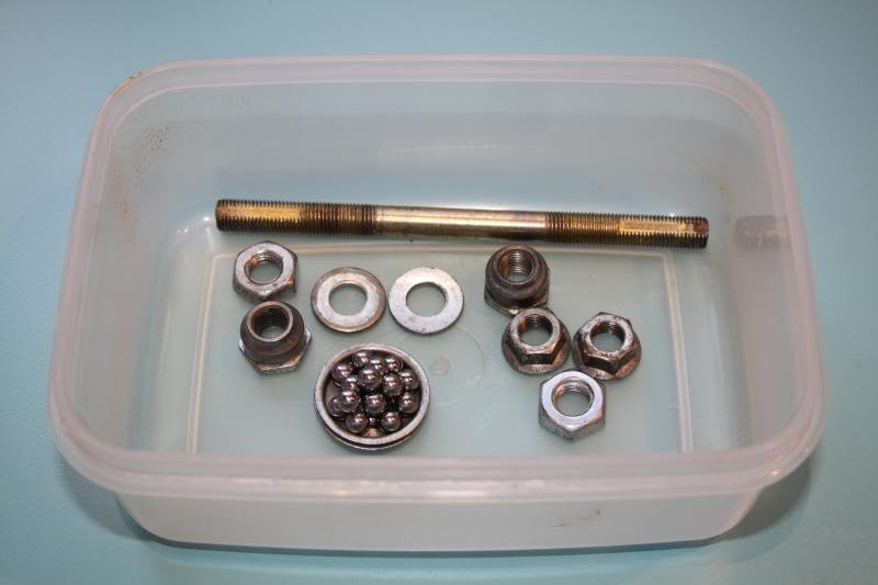

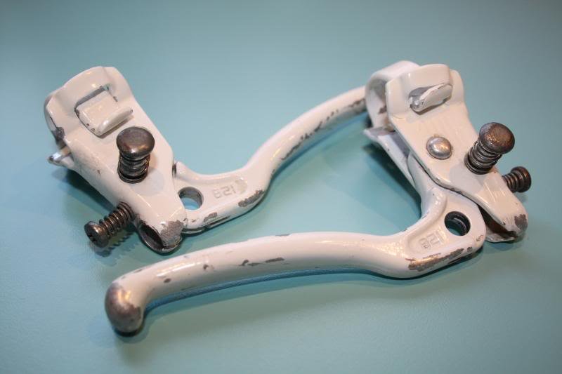

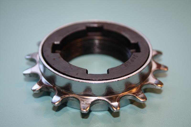

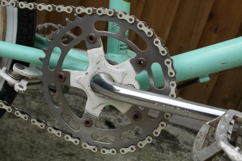

Cleaned and serviced a few bits:
Serviced the freewheel, using the handy guide on here :daumenhoch:
Took delivery of these:
Cleaned and rebuilt the hubs:
And finished off the wheels 8):
Pleased with the whiteness of the tyres.  Not too bright, so they match (kind of) the rest of the white parts :)
And started to put the old girl back together after cleaning and polishing the frame:
It's nowhere near finished yet, still needs brake cables and tweaking.  Trying to get it ready for the London Ride.  :daumenhoch:

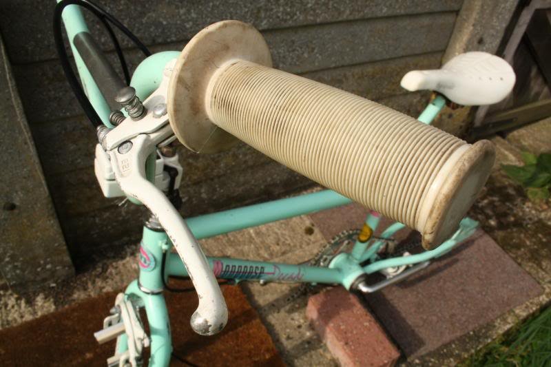

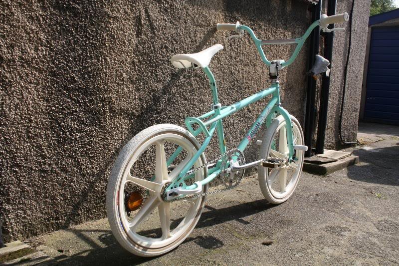

A couple of finished pics, just dialled in the brakes ready for tomorrow's London Ride 8)
Offline brakedancer
  • Posts: 404
« Reply #24 on: April 25, 2014, 11:36 AM »
spot on dude look tremendous ..... :)
