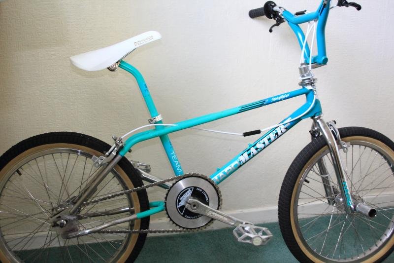

i,ve painted all but two of my bikes with rattlecans, 3 light coats of primer, followed by 3-4 coats of the colour of your choice and 3 coats of laquer. some fine sandpaper inbetween some of the coats to flatten out any issues and thats it. they don't get ridden anyway so no worries about them getting chipped. for cheap paint in almost any colour try graffitti suppliers, about £3 for a 400ml tin. i got an almost perfect colour match for my teal/mint haro master from graff city.

Sweet job John quality :daumenhoch: Dan give that F&F "wantit" lol,if you keep the can close to the F&F your going to get bad run lol sound like diarrhea there excuse the pun :p all god job on the F&F guys i might give it a go and if i B@lls it up hey ho of to dans it will go :D
