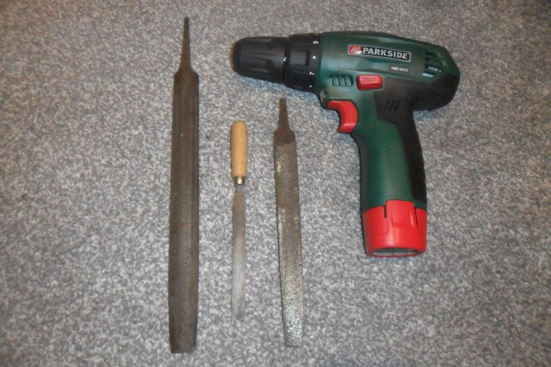

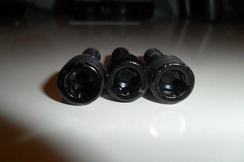

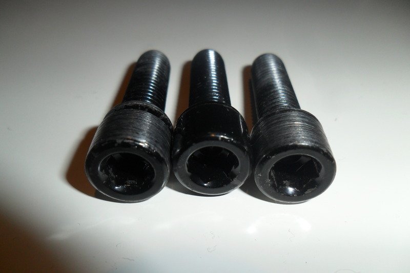

Had some trouble tracking down a  M8 X 30mm bolt, You would think this would be easy but normally these bolts have a 13mm dia head. I needed a 11mm dia head, Found some on chainreaction cycles, But the head was still slightly too big for the hole. Well after some kitchen engineering I have a bolt that does the job.
Here are the tools I used :LolLolLolLol:
Bolt in the middle is how the 2 outer ones started, Difficult to see but enough machined off to make them fit. Just need to give a quick coat of gloss black and that's it. Now have a useable stem :daumenhoch:
