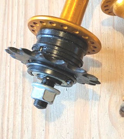

got these Gold Shimano hubs
thought they were DX but some digging about has shown they are MX hubs, HF-500
stamped up
FL  - Dec 1981
GA - Jan 1982
they have a 15 tooth gear and split ring
the cog will slide on and stop, but the split pin sits in a groove on the outer edge
so the cog is still free to slide sideways
is there a spacer or something that's required?
there's little info on the hubs let alone the parts ...
cheers Kev

Is there a plastic castle thingy behind the sprocket? That could be what you are missing.

That's what i  thought
Just not seen a complete set of MX hubs to confirm

I took these from the JBM Catalogue (Jan 81). Hope they help ;)

Looks like you've got the Model FH-MX60. Hard to see a collar on them. Is there room for another split-pin behind the cog?

 :) You should be able to easily get cassette spacers (even coloured ones) from any MTB shop that will stop the sliding and enable you to get perfect chain alignment.

Good idea.  :daumenhoch:
A trip to the LBS
Hub in hand
cheers Kev
