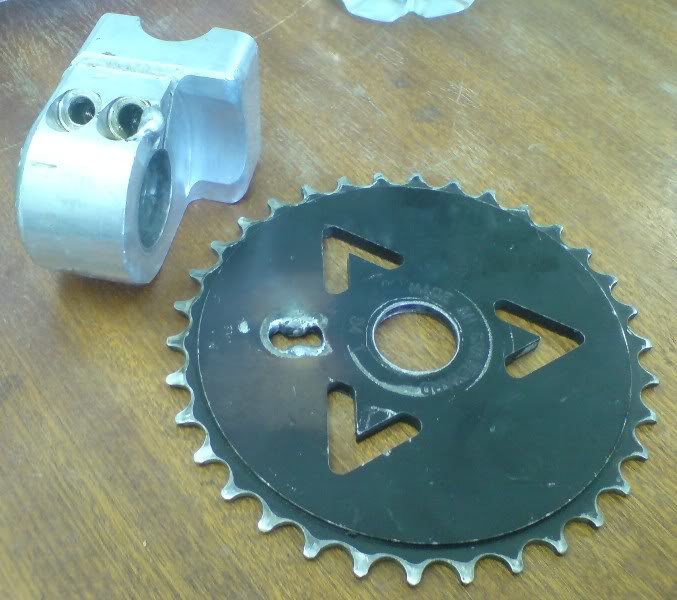

Also I dropped off my Graveyard sprocket and Basic Millennium stem for welding. The stem itself I ran for 11 years and when I decided to retire it the other day I found a crack in the clamp bolt hole which I am welding up. The sprocket mounting bolt also has worn a lot so I am running some bead in there to pad it back out then I'll machine it back to shape. Nothing drastic I just want the bike to function perfectly.

After a long wait I finally have my parts welded up and ready for re-finishing.
The stem crack was cut out and filled, and the crank bolt hole on the sprocket was filled out with bead because of the wear.
Next up is to strip the anodising on the sprocket and then machine both holes back to size. I am also going to eventually polish the sprocket a little as my original sprocket was silver. Also I am going to clean the stem up a little taking off some burrs here and there but while trying to leave most of the riding patina.
Here they are now looking a little rough fresh from the work bench...
