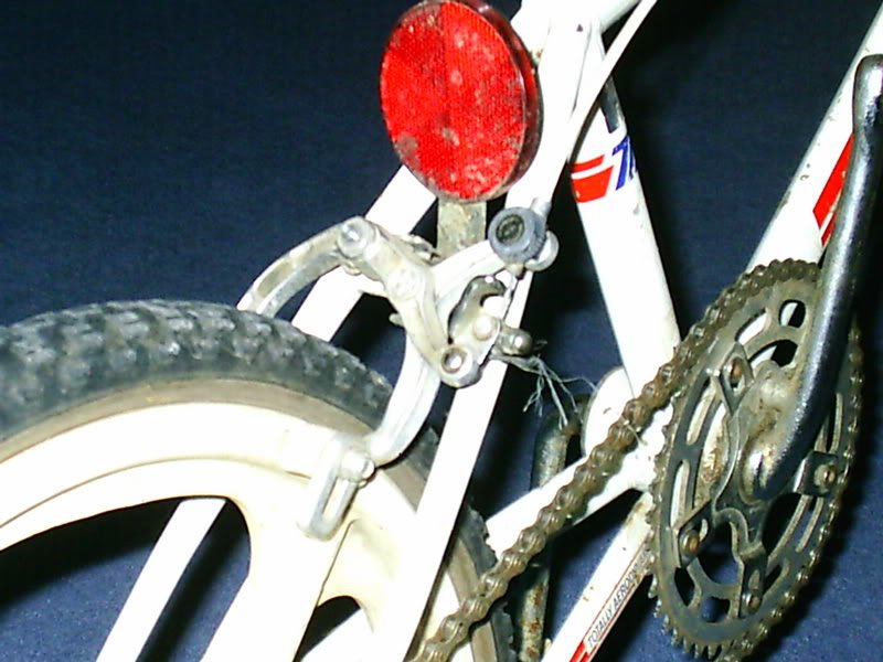

Some of you may remember this...
I was given it to look after about 6 months ago, and it was in a real state. It had been left outside for nearly 20 years and was pulled out from under a pile of manure. The skinny Araya's where no longer with the bike or the seat clamp, it had most things seized but worst of all a stuck DX.
The chain was rusted solid, and the DX would not move...
After it's first wash it had potential -
And a very nice stem was under those pads -
I put some wheels into the dropouts, just to save any damage (as there are another 10 plus bikes laying around here and wanted it to be at hand rather than in with my storage collection) from wheeling it in and out and to also be able to give it a spray etc and try and get that bl00dy DX out......
The post would not move and finally it came to the crunch, the only way this bike will ever become a ridable survivor would be by cutting the post....so cut it I did, about 1cm above the frame, then a pilot hole (DX are solid posts) was drilled at the same angle as the tube, followed by a larger drill and then a larger drill. Next out with the electric saws and fine blades. I cut at an angle of about 30 degrees and swapped from a Bosch big saw to a hack saw blade near the end (for absolute precision). Next it was out with the Vice Grips, and I squeezed the post together......put some more oil, plus gas etc etc down the sides of the post and then clamped on with the grips and gave it a very gentle twist of about 2mm each way, increasing buy about 2mm at a time until finally it was free. I then used a Bosch lenthening bit and attached a wire wheel and cleaned it lightly inside the frame and put the DX back in.
I put in some new tubes, had to cut the palstic outer cable (as the inner was too short - as the brakes were set up for Araya skinnies). Got another nice and rusty old Izumi and took out a couple of links and fitted the wheel with good gaps, sprayed it again and took it for a blast.....
It is as quick as hell and runs smooth.
I never wanted it mint (or to get rid of the rust) as it has history and was an EA race bike and if a full resto was started, it would have been impossible to finish....I doubt i'd ever get another stem or pads etc if any accidents happened.
I was not going to post pictures, but enter it as a survivor in a show, but am after a few bits DX (post especially as the seat sits just a bit to low, plus skinny Araya's....
Comments welcome.
J.
