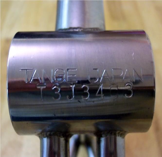

here's a pic of my bottom bracket on my mk1 cromo burner ;)

« Reply #11 on: November 29, 2006, 11:12 PM »
as far as i know Kuwahara never stamped "Tange Japan" under their BB's!
if there was a factory stamp it would just say Kuwahara not Tange!
i reckon the only kuwahara it could have been is the Trimoly Nova
But they are stamped differently under the BB as shown below so its still looking like a cromo Burner!
which funnily enough has a mild steel rear end so is really Trimoly  ::)
« Last Edit: November 30, 2006, 12:15 AM by showtime »

i use Jamies site as a reference along with some of the guys on V, i always use pics from Jamies as its so quick to find them  ;)
i was thinking Nova until the guys with Burners in front of them posted pics with identical stamping etc so now i'm leaning more towards that  :-\
plus its pretty unusual to have anything more than the number stamped into a pre 84 Kuwahara  :-\
we're all still learning & remembering everyday ::)  :daumenhoch:
