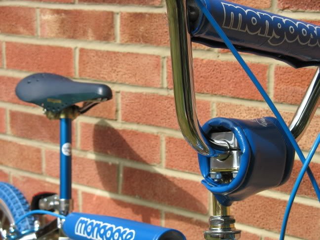

dont get them chromed gav stainless will polish up like chrome,i did a set for my supergoose,i removed the small dings with dent pulling tool we use at work then polished to mirror finish they came up like this

hi gav i cheated and machine polished them ,you wont get them really shiney doing them by hand as stainless is a really hard metal and takes a lot of time even when using a polishing motor :(
