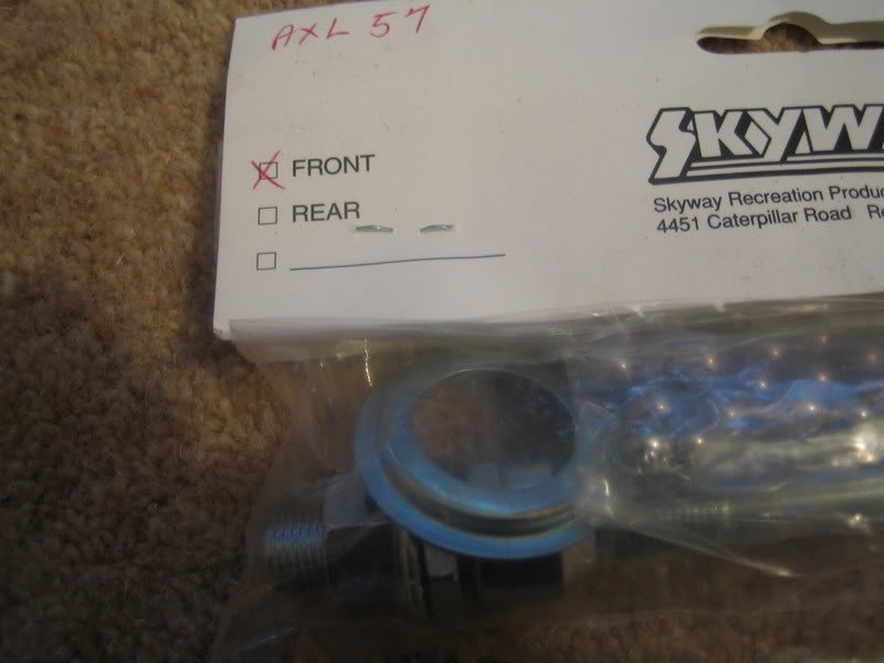

I've just fitted a front axle rebuild kit to my Skyway and come to fit it on my Gen1 forks and it wont go through the gap in the forks!!! >:( >:(
The axle doesn't have the usual flat  spots on it like the old one. Has anyone else bought one of these and is it the same. ie. without the flat bits on it ???

its cos youve got a rear axle.....front skyway axles are already fat on two sides to allow you to fit them in slotted type forks

I ordered a front one & it says front on it, but no flat sides  >:( so Iv not used it

Yes that is where I got mine from.
Re: Skyway axle rebuilt kit - wont go through my forks.
« Reply #7 on: March 25, 2007, 10:42 PM »
they did two types of axles
as theres two types of fork dropouts lol
and ive onlt took enuf of the axle to fit em in said forks
and nuts still go on sweet
