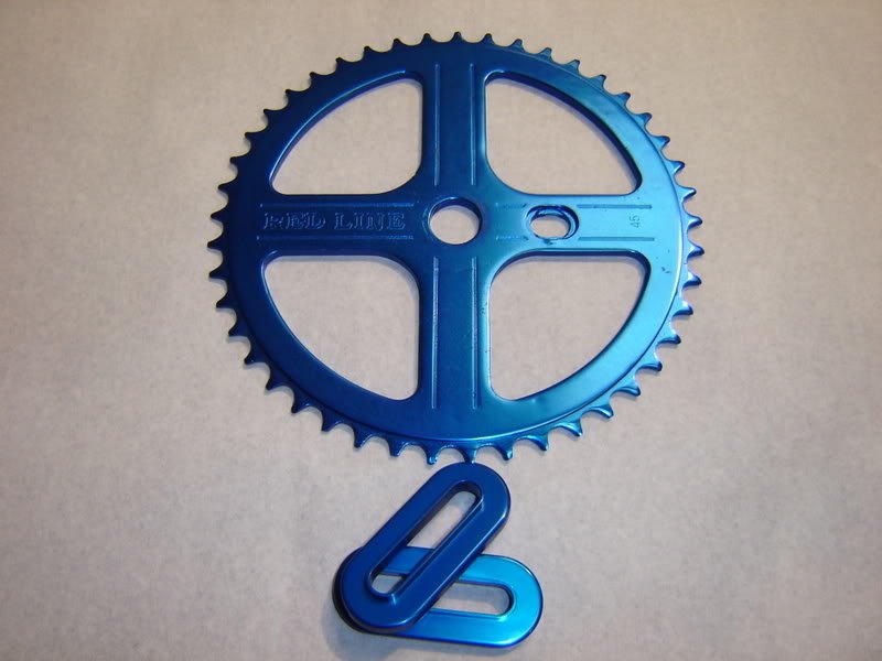

thought i would share
Re: anodising services and prices "PIMP YOUR BIKE"
« Reply #37 on: June 07, 2007, 08:01 PM »
Look very nice, going to get my Tuf Neck stem done in blue when my mate gets the shaft removed this weekend  :daumenhoch:
