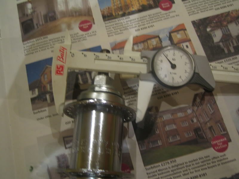

Re: Seatpost/seatclamp diameter
« Reply #5 on: May 06, 2007, 10:01 PM »
This is a Vernier caliper, but don't get a digital one, cos when you go to use it, the battery has gone  :(

Offline Moose
  • Posts: 2328
« Reply #7 on: May 06, 2007, 10:15 PM »
That picture came in handy afterall  :daumenhoch: :LolLolLolLol:
