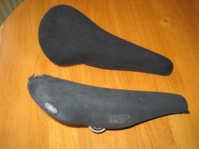

« Reply #4 on: June 14, 2007, 07:36 PM »
heres some pics,one restored and one badly faded,the bit underneath seat which has lifted looks black?

i reckon it started off black as the rest of the bike is that sort of colour :smitten: :4_17_5: :Great_Britain:

Kashimax Five gold saddles in black suede come up nos every now 'n' then on eBay. Usually sell for well over a hundred pounds tho.  :daumenhoch:
They are real suede too. And do look dark grey if the suede is brushed whichever way that catches the light right. Especially once they've worn in a bit   ;)    G.

Suede Kashis on Turbos were Black. They grey with age. You can restore them with Dylon suede dye and then finish the knap with a small brass suede brush :)  Or you can send it to me and i will do it for you   ;)
