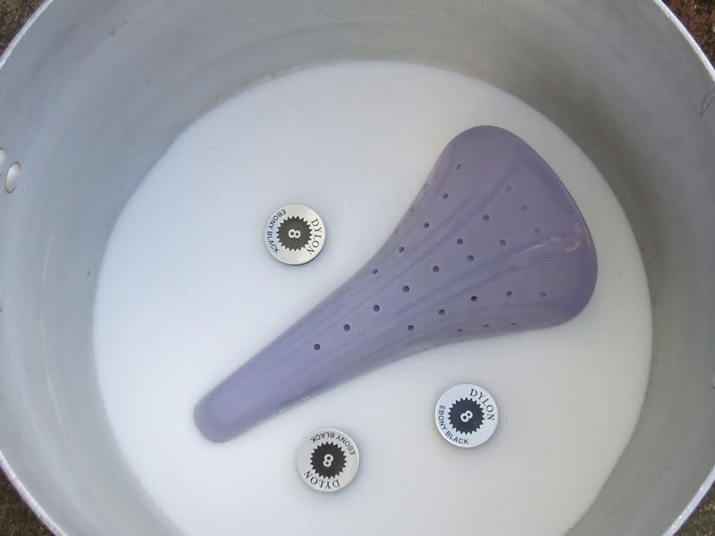

You could dye it black instead ... here's one I've done recently  :daumenhoch:
Steve

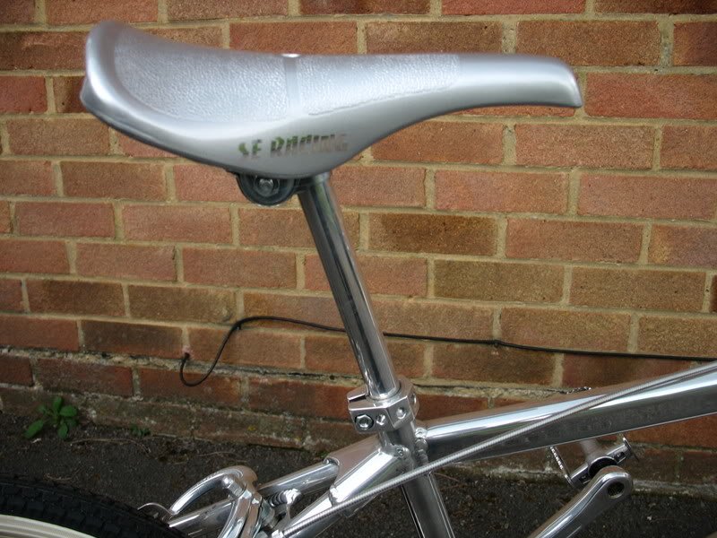

you can paint them,i did this in 2 pac,but make sure you use a plasti flex primer :daumenhoch:

 :shocked: :shocked:  Kinell dude, that seat is the bishops bongo drums :daumenhoch:

This dyeing lark is not as easy as you think
I tried to dye a white seat red ... i ended up with a lovely orange seat no matter how many times i tired
buy another
