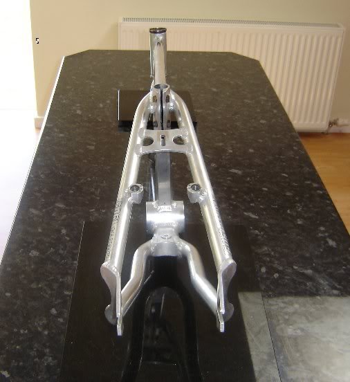

« Reply #2 on: July 28, 2007, 01:38 PM »
It finally turned up yesterday!!  :) I was getting nervous....
Anyway, is it a 93 PKR-XL, was it worth £98, and will my old school spares fit it...(what do people think about the new 07 looptail limited addition (restore this or buy a new looptail?)

nice frame    :)  and yes well worth the money ,i like the long rippers   :daumenhoch:

« Reply #4 on: July 28, 2007, 02:30 PM »
Not sure if you can use MX1000's on the brake bridge , looks semi set up for V brakes .
If it's 1" 1/8 ( no thread ) headset then your SR stem won't work .
Nice frame though and deffo worth building as NS thrasher  ;)

« Reply #5 on: July 28, 2007, 03:01 PM »
Nice frame ... I've got the earlier version which accepts all old school parts  :coolsmiley:
Your old school parts will fit your Ripper though you'll have to get 1" threaded forks to use your SR stem. Use a straight post too ... the TT is a nice length without the need for a layback
You could remove those v-brake lugs to make way for an old school caliper ... the bridge will take an MX1000. It should be an easy job in the right hands but I'd be inclined to leave it as it is and build it with the right parts with an old school flavour  :daumenhoch:

I think these are set up for both V brakes and pitbull (at the bottom) and possibly a normal side pull, nice to have the choices :daumenhoch:

« Reply #8 on: July 28, 2007, 03:47 PM »
It's quite a rare bird being as it has both brake variants. I'd put it at 94-97 myself though :)

I used the MX 1000 on my alloy quad and that fitted great , had a battle with the headtube as it takes 1" 1/8 threadless forks, but managed to shim it up and fit some 1" alloy forks in the end .. Bike feels a mile long after riding the Gen 1 and GT , but love it, and one bike i will never part with .. 8)

after 96 they went to "oversized" or 1.1/8" headtubes
means the lg's will be cheaper ;)

The only reason I thought it could be 93, rather than a later model, was this post on a US forum regarding identifing Rippers (and it has both upper and lower brake cable guides?:
'79-'84 = Loop tail
'85 on  = built in seat clamp, non loop tail
mid '85 = straight chain stays (only one year before the change)
'86 on  = curved chain stays
'90-'93 = lower Pitbull brake mount
'93 only = upper and lower brake cable guides
'94 on  = canti or v brake mounts
'95 on  = 1 1/8 threadless stem/headset
'98 on  = 'SE' downtube decal instead of 'PK Ripper'
'99      = last year for US made products before sale to Fuji
Does anyone agree with the above?........
