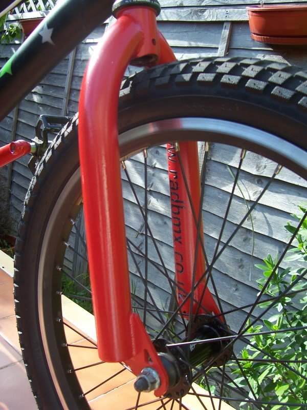

ive got a some handlebars that tare pitted and the chrome is off when wire wooled em,thinking of doing a rattle can job on em,also a frame.has anyone got an example of a job done [pics]and any helpful tips would be hugely appreciated........cheers

ZED is a good bloke to ask......he's always spraying his bits
but if you do spray anything then it's all in the preperation, make sure the bits are all washed and dry and have no grease on them, try not to touch them with your fingers as this will leave grease on them.
then primer......top coat........then laquer

prep it mate sand it right down , till its all smooth , get some plasticote under coat from BQ etc , and there colour paint , it works great , t,cut after 2-3 coats, then get some clear coat , will last ages and looks great

if you just want a flat base colour use hammerite spray
get the can warm
make sure the surface is flat and clean
spray in thin layers - don't lash it on
heat is the key - spray in a warm place
once the bars are dry enough to hold, put them in the airing cupboard (or somewhere warm) for a week

i always sand down after primer with 1200 wet and dry, also after main colur 1200 to a dull finish then lacqeuer, i just recently did all 4 mvs on my bmw which look fooking awesome but it takes serious patience, to be honest getting dan to do them wont cost you much more than it will to buy all the shit you need from halfords, and if you havent done it b4 be prepared for tears

just dont do it , looks ok , never get an amazing finish , then as soon as something touches it it falls of and looks terrible . trust me getting it done proper
