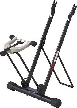

the truing is the part that takes the time but get one of these (or an old pair of forks upside down in a vice)
and also then refer to the excellent Sheldon Brown truing guide
http://sheldonbrown.com/wheelbuild.html#tensioning
