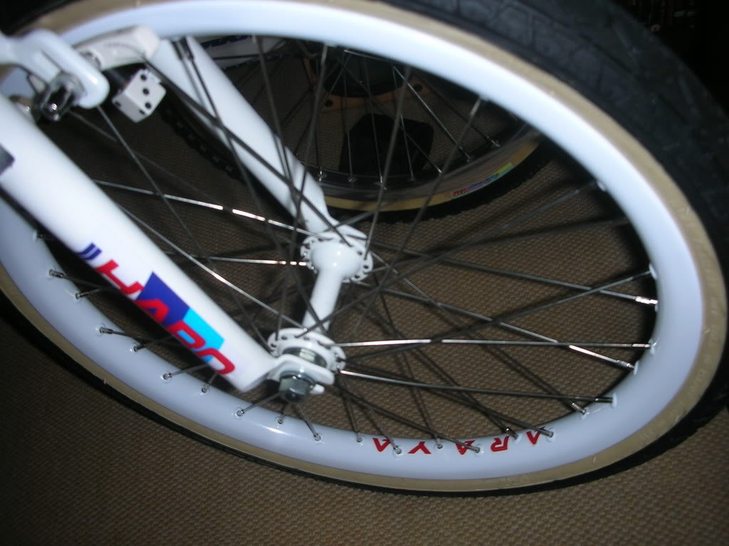

Hi people
Hoping someone can help me.
I need to relace front and rear Areya Aero wheels which have Suzue Low Flange sealed bearing hubs. Can someone tell me what size spokes are needed for the front and rear?
Also whereabouts can I get the spokes from?
Cheers  ;)

i have just had these done, now i think it depends whether you do 3 or 4 cross but these were definately 184mm long ...fact  :daumenhoch:
hope this helps

« Reply #4 on: November 17, 2007, 08:22 PM »
184 = 3 cross
194 = 4 cross

Re: Araya aero spoke size
« Reply #5 on: November 17, 2007, 08:38 PM »
Go for 3 cross and the spoke length is 184mm as already mentioned.
I always go for 3 cross because you're then able to replace individual spokes if needed.
